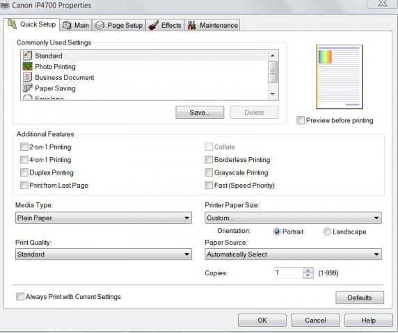

I am sorry but I dont use OpenOffice so cant guide you through the print steps for that application.
However I will use my iP4700 print set-up to guide you to the last stages before printing.

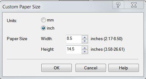

As on the picture below just select your Media Type first the Printer paper size next.
If you have a problem with the Media settings then set them after you set your paper size.
In Custom Paper size put in your size as the picture is set to below and click ok.
Then if you wish to use a different Media setting Glossy/Matte now try setting it
but afterwards re-enter the Custom paper size settings and check that they are still set correctly.
Now use which ever paper you want too and click on print and the jobs oxo ok.
One other point to consider is does OpenOffice have a print per-view if so
check that it is correct and your entire image is visible and not now short..
