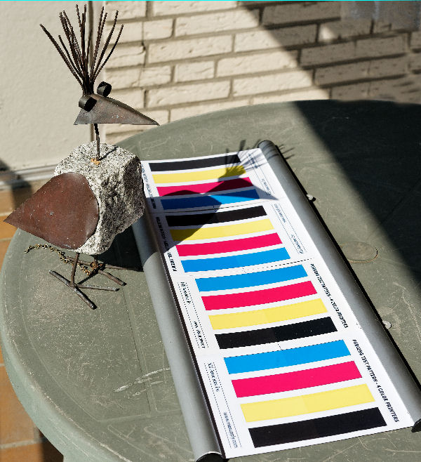

I'm currently running a small test to check how much a gloss optimizer overprint on prints with dye inks changes - improves the fading of these inks.
I printed the color bar patterns a few days ago, on 4 different glossy photo papers, first changes are becoming visible already after a few days - yes, a GO overprint improves the ink fading. I'll have some numbers to compare in a few days. The inks used for this test are a mix of various and no-name inks - OCP - Chinese - leftover of L300 inks. I may run a 2nd test with the Fujifilm DL inks later.
Using a GO overprint on dye inks is not typical, and Epson printers are not equipped for that, I'm using a printer running dye inks e.g. R265 or WF-2010W - and do the GO overprint with a R800 for these tests. There is another side effect - the GO reduces the sensitivity of glossy dye prints against fingerprints and changes slightly the overall look, darkens the colors and changes the look of the paper white. It would be necessary to run a separate icm-profile in such case.

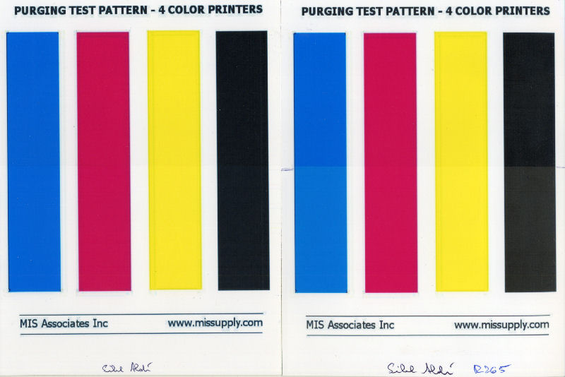

The effect of the GO overprint becomes visible already after 1 week of exposure to the outside.
The top part is GO covered, this is the Sihl/Aldi paper, the unprotected black is already turning dark brown, the left part is the reference print kept in the dark; it looks very similar on the other papers - Netbit/Aldi, Tecco PG230 except the cheap cast coated LS180 which does not show much of an effect of the GO at all, I'll show it next week. I used in the last years a budget cc paper Labelheaven, but that was bending slightly from the environmental humidity once the package was opened, and it was not feeding well/at all in the L300 in that condition so I phased it out and switched to this LogicSeek paper, about the same price, this one stays flat and runs well on the L300, but it turns out now that the fading performance is poor...
Considering the effect of the GO overprint I could assume that it protects the paper surface with the dye inks more against ozone than against UV, I'm doing this test outside. You typically have less ozone inside the house, thus a less protecting effect which could support The Hat's findings of a lesser GO effect with his test, aside from the difference that he is using more stable pigment inks.
I'm recording the lightness numbers of the color patches so I can see in the next weeks when the GO covered areas reach the same level of lightness increase as the unprotected areas now, so I'll update the findings in about a week.
