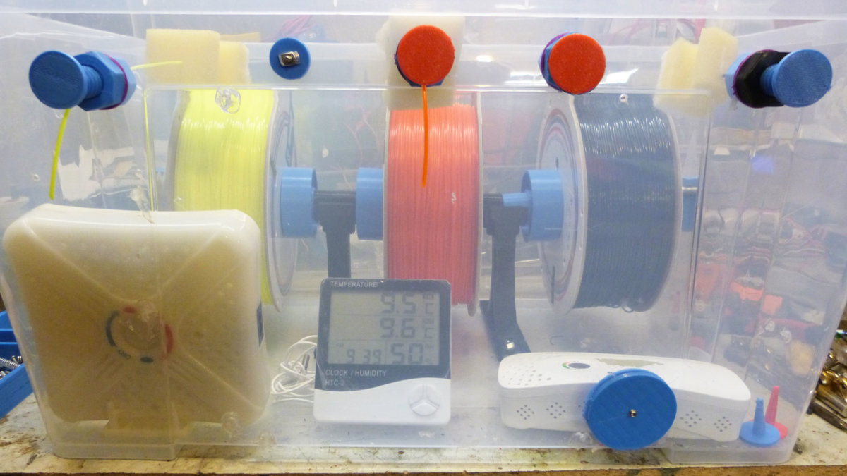

I also have a bunch of the cheap digital humidity meters in all my boxes. Usually hovering between 10% - 20%

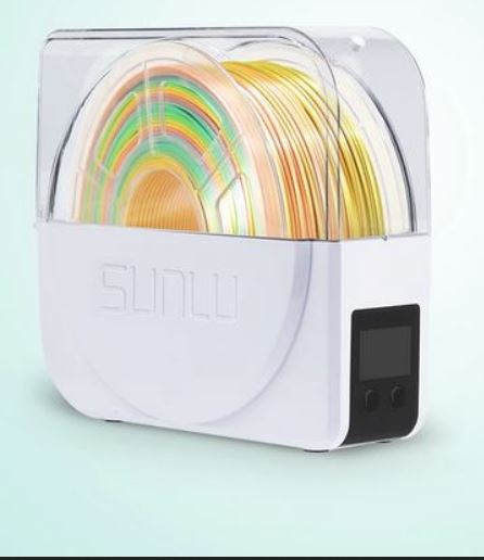

I just use Desiccant bags in my filament box which I warm up when needed on the nearest radiator for a few hours, and it seems to keep my filament boxes at about 50% humidity, I also use a Sunlo dispenser with built in heather and don’t have any feeding issues with them either..
