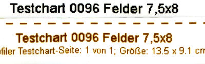

I stopped the last fading test 2 days earlier because of adverse weather conditions - it's 12 days of exposure - not 2 weeks. But the results are evident
the top line is printed with the Epson 106 inks, the bottom line with the InkTec E0010 inks , it turned into a nice milk chocolade brown, the prints with the other inks are very similar. The E0010 ink is specified for use on a range of Epson 4 color home printers with a dye black, including various L- and ET- series Ecotank-printer models with the 664 inkset.
Give me some more time to get some numbers together to show how the inks in this test rank to each other.
