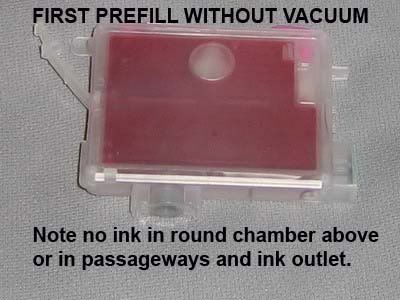

websnail,
I think I'll make a couple of comments on spongeless cartridges and I think you'll find these quite enlightening.
There are various designs and some are much better than others. How can you tell? First see if there is any type of flow regulation and damper system built in. You will see a small round chamber somewhere in the middle of the cartridge. If you do, you are getting a chance to have one of the better ones. The better ones have this chamber and then have something else that you can't see unless you take them apart. They have a semi permeable membrane. This membrane is like an extremely fine filter, it's main purpose is not to filter but it does that as well. How these work is very interesting and enlightening. The membrane is loaded with ink on one side and the ink does not go through. When a very small vacuum is applied on the other side, the ink oozes through the membrane. This is special because the cartridge itself becomes a mini tank system and the chamber/ membrane etc is the feed system. What it also reveals is that the cartridge will not leak ink out through the printhead even if the cartridge is totally unplugged or unsealed.
These same cartridges are used in some better CIS systems. This essentially makes the CIS less sensitive to tank and hose issues.
This design mimicks the Epson OEM design parameters.
The only issue with this design is that for best performance, the filter membrane should be kept fully wetted on one side with ink. Unfortunately the only way to properly do this is to initially prime it with a vacuum chamber to evacuate the internals of air otherwise the only way to get this air out afterwards is through the head..... something that experienced Epson owners know they should avoid. Other than that these work well if properly primed.
So with a good design, you don't need an air break within the top 10% of the cartridge. This air break you speak of is actually after the regulator membrane if you look carefully, this stops the membrane from leaking ink through by capillary action. Look carefully at the pics.
