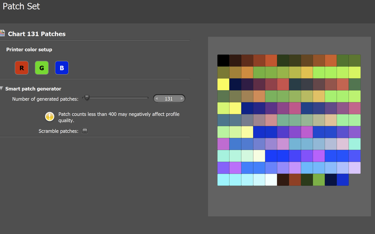

Because the i1Pro2 is superior to the Spyderprint device, I decided to make a similar target for the i1Pro2 for th i1Profiler software using a base 131 patch base target of which the last 6 patches I removed from the file using the patch editor function in i1Profiler:
The last 6 patches has been removed in the patch editor function of i1Profiler and using the Photoshop function to determine the exact RGB-value of the Spyderprint high quality target of the additional colours I added the extra 100 patches of the Spyderprint target to this custom 225 patch i1Profiler target and this is the result of the target:

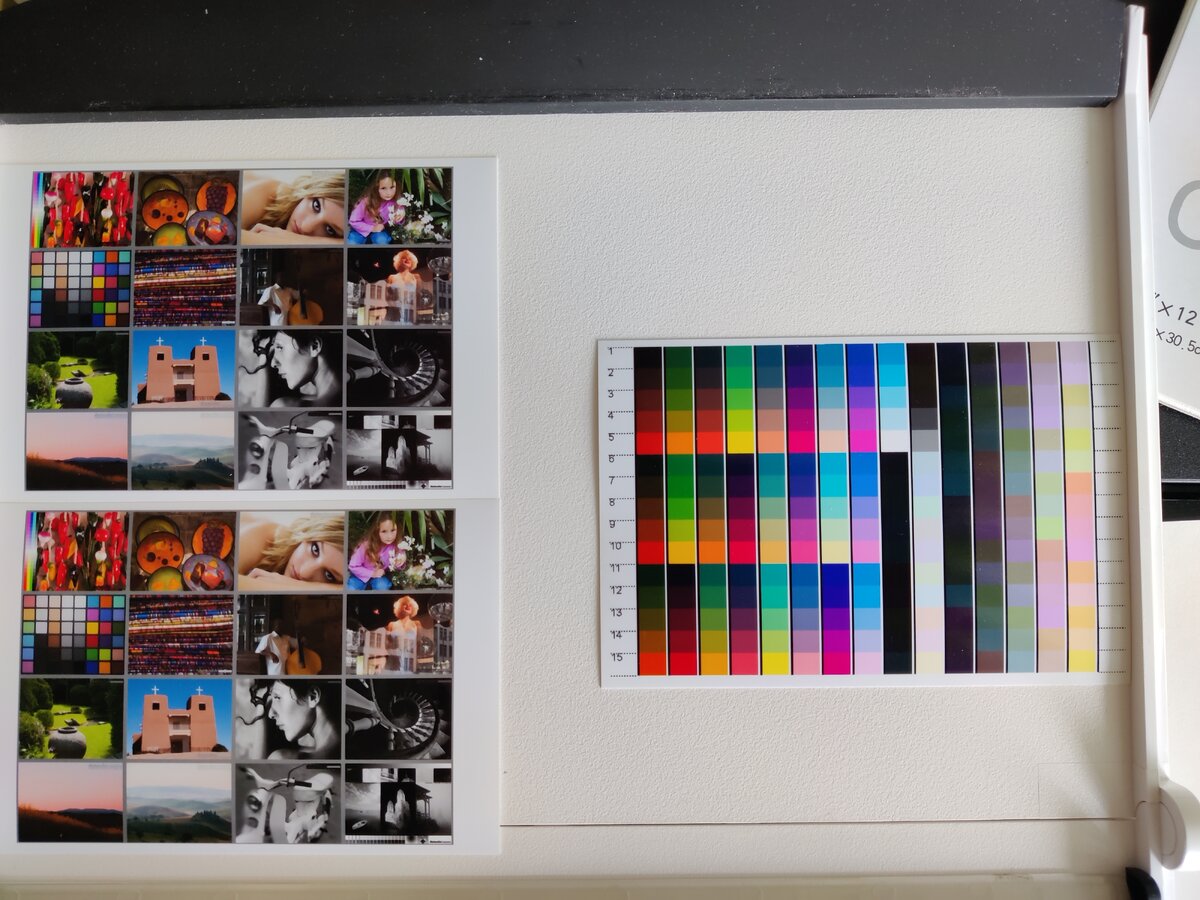

The whole target can be printed an small 10x15 cm photo card enabling profiling using only a small piece of photo paper, I printed the test target using this limited 225 patch count target and a much larger 918 patch target (based on the TC9.18 printer target) and this is the result:
I can see hardly any difference and the result is identical to me, including the dark shadows (no lost of details).

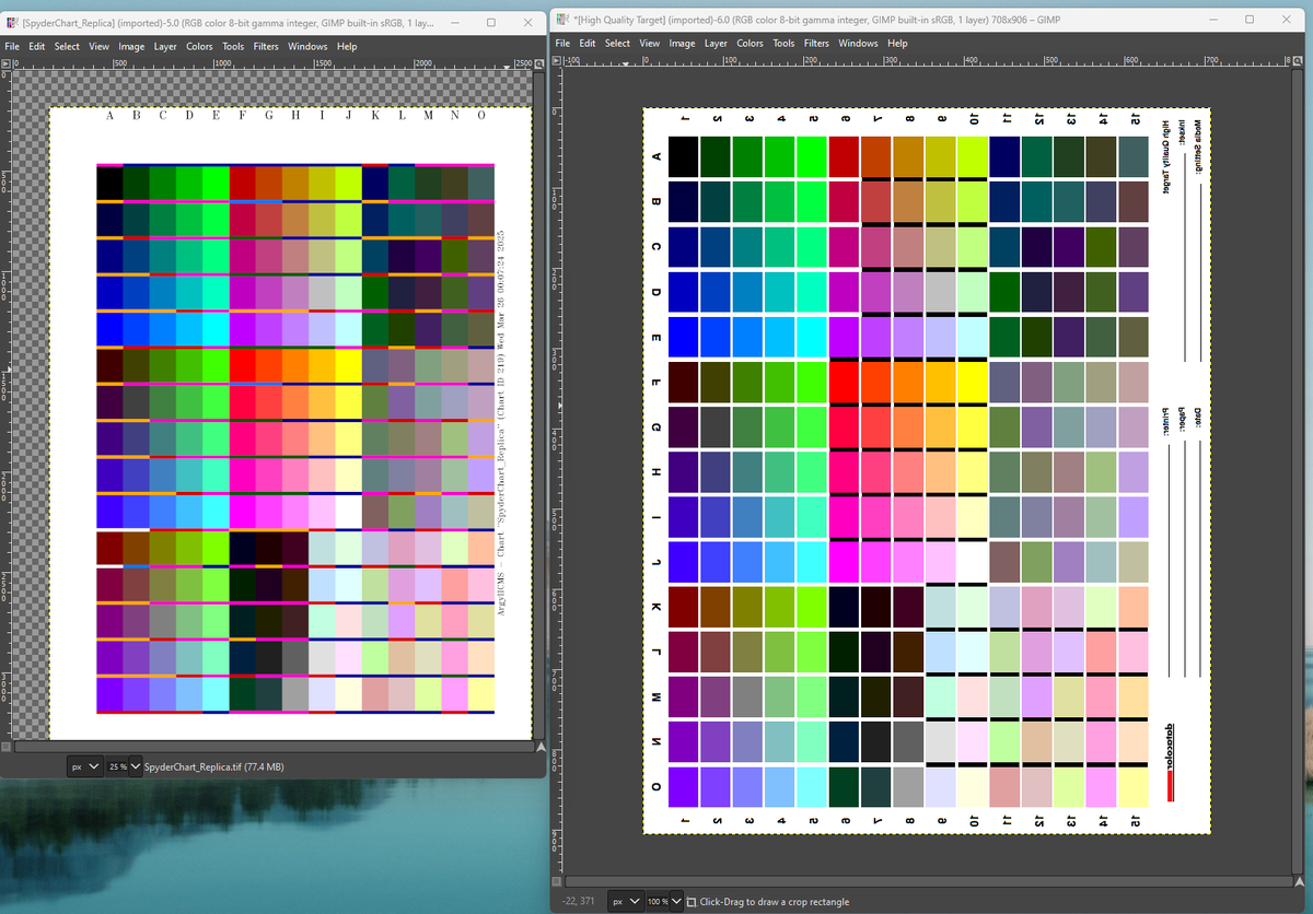

Attached is an ArgyllCMS version of the spyderprint 225 patch chart.
To do this, I pulled all the RGB values from the original chart and ran them through xicclu to get xyz values. These are needed to have a rough idea of what the expected result is when read back with chart read. I then used this command in printtarg to get the exact 15x15 layout as the spiderprint grid and also disable the randomizing of patches. Some experimenting may be needed for A4 paper
printtarg -v -r -ii1 -a1.4 -T300 -p Letter SpyderChart_Replica
Because argyllcms charts dosen't support custom patch sizes, I had to use an existing format. With my chart, row A read from top to bottom corresponds to line 1 in the original datacolor chart. B corresponds to line 2, etc. Technically you would be able print out my TIF file and read with a colormunk or i1 in argyllcms or with the spyderprint, one patch at a time. Here is the original chart next to mine. I flipped and rotated the original target to help understand the layout but with the original rotation, if you compare ArgyllCMS "B2" to datacolor "2B", you will see that the RGB values are identical.
