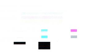

I did another nozzle check today, Monday 5/31. The black does not print with the small color grids at the top of the page. But it does print mostly at the second section, which has the bars of color. The yellow is lime green. One of the "solid" black boxes has banding; 3 rows are black, 3 rows are grey.
When I soaked the print head, I let it sit to dry overnight (I live in AZ, the weather is warm, and things tend to dry REALLY fast). And if the print head were damaged, wouldn't all the nozzles have trouble, not just the black? And why is there color banding?

Since I have never seen an S750, I can only guess what the nozzle check is supposed to look like, but if it is typical of Canon printers, it should look something like this except that you won't have the BK at the bottom of the nozzle check:
You mention purple and lime green which should not be on the nozzle check. If you see these colors, it indicates that the cyan ink is leaking into the magenta (making purple) and into the yellow (making lime green). It may actually be contaminating the cartridges in which case you should replace them. Then you can see if they get re-contaminated and if they get mixed on the nozzle check. If there is a leak inside the print head, you're going to have to buy a replacement print head which should solve all your other problems. It's going to be expensive to buy three more color cartridges just to find out, plus the print head will set you back over $100.
It is also possible that the leak is occuring outside the print head, on the purge pad where the print head parks.
One other thing: The black grid lines at the top of the nozzle check are produced by the wide pigment black ink cartridge. All the other images on the nozzle check are produce by the three color dye ink cartridges. The blocks to the left of the bars are made with combinations of the three color dye inks so that they look black but they are not made from the black cartridge.

The link for your first image is messed up--you need to fix it. You don't need to use the Thumb link for these small images, just use the Image link.
It looks like the nozzle check prints both a nozzle check and the results of the alignment. Your second link is so faint and low resolution that I cannot tell what it is. The large grid pattern at the top is for the wider pigment black ink. Below that are several smaller grid patterns but I cannot tell how many there are nor what their colors are. Do you see at least one of magenta, cyan and yellow? How many grid patterns are there in total?
