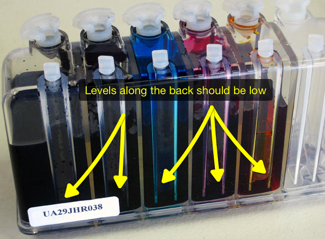

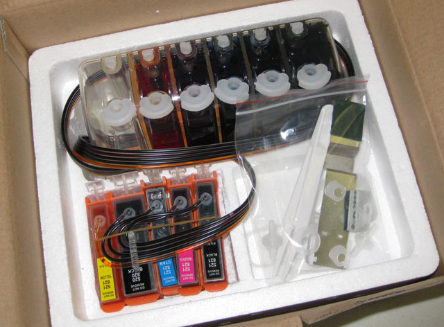

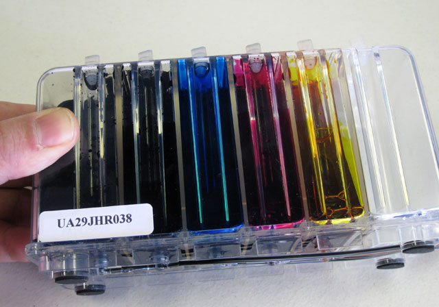

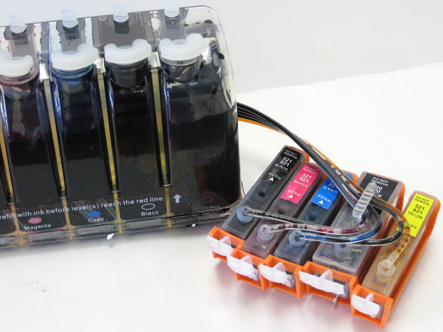

Here are some pics of the CISS i intended to buy, although I guess that might change now - :|,
These pics make this specific unit look fairly sturdy, i like how the external tanks are all connected, and aren't 4 separate things moving around.

I knew before I finished the last post what you intentions were, that you would prefer CISS over refill. Thats fair enough your decision which I respect, as I use a half dozen CISS units myself so I know the value of them.
The system you showed looks the business all right but cant say anything about the ink. As I said earlier dont use pigment ink in the CISS its not worth it. If you got yourself an older canon printer the CISS system works better on them than on the newer ones. Canon as I write are trying dam hard to stop people using CISS units on their printers that why the newer ones are more difficult to convert.
