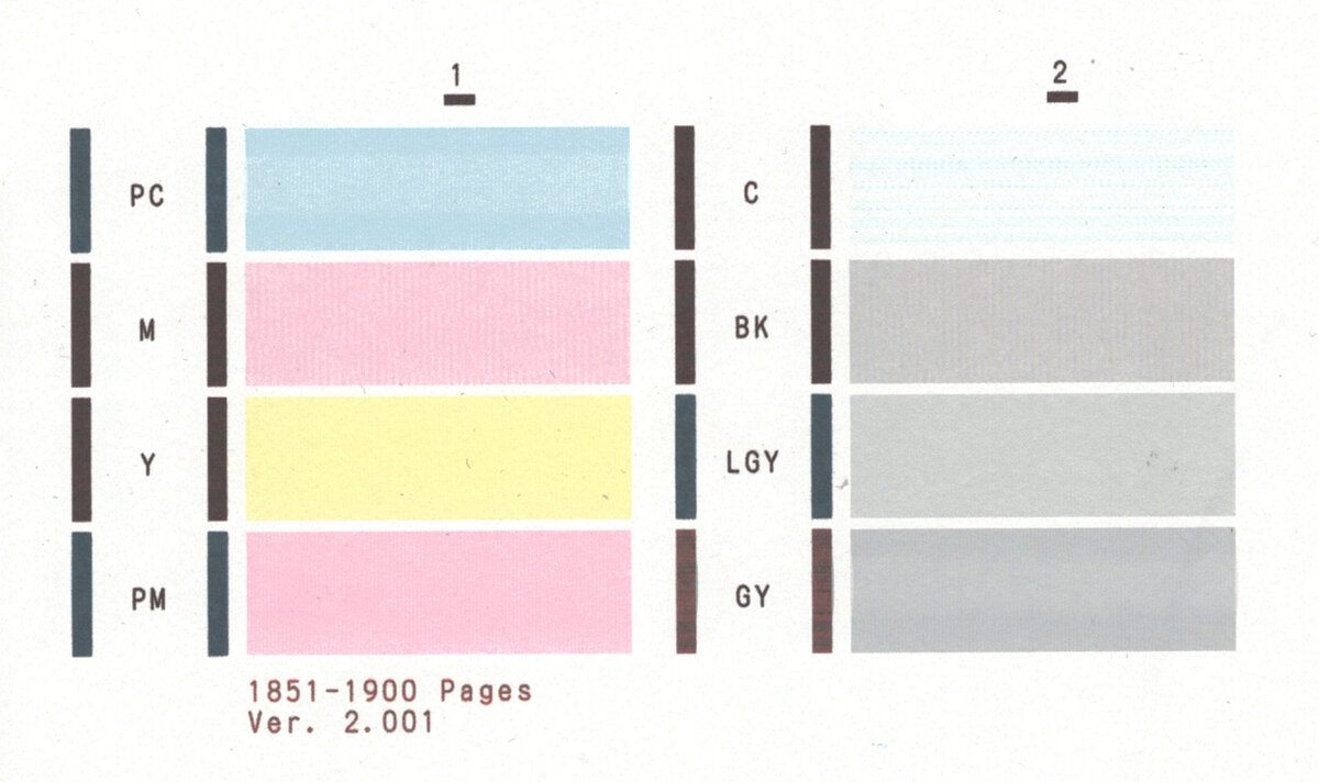

I'm hoping the experts here can help me figure out the stuttered pattern on the CYAN channel.
What might be the cause ? What are my next diagnostic steps ?
Thanks to those whose posts I've read thus far ...
HISTORY:
Precision Colors in OEM Canon modified cartridges.
Have tried cleaning printhead (windex, distillled water) with resultant perfect Nozzle Check, but shortly afterwards, this CYAN pattern returns.
Have tried two sets of OEM modified cartridges.
Have dripped windex to Waste pad and confirmed ink is pumped away.
Have confirmed CYAN ink is flowing (drip drip drip) when silicone plug removed from drilled hole of modified cartridge.
NEXT:
Have ordered an new Canon OEM CYAN cartridge to rule out bad sponge in modified cartridge(s).

The new OEM cyan cart will be your last resort, if you run 5 or 6 test prints and the nozzle check doesn’t improve then only a new print head will solve your problem..
The print heads in these printers are not designed to last for ever…

Thank you for replying .... YOU were one of the experts I was hoping to hear from ... HAHA.
The printhead isn't actually that old ... less than 1900 prints. What I couldn't figure out was why the NozzleCheck after printhead (windex) cleaning was "perfect". But after a couple of weeks of intermittent (infrequent) printing, the "stutter pattern" returned.
I was encouraged during the printhead cleaning because I noticed this ... I soak a thick folded paper towel with windex .... then place it in a tray. (Windex only in the paper towel). I sit the printhead on top, and let the windex fumes soak into the printhead ... I see the paper towel soak up the ink from the printhead. What I found promising was when I pushed down on the printhead ... I could see the windex coming up each color channel. This makes me think the printhead is not clogged. Does this make sense ?
I reckon your ink may have something to do with the problem, try purging the cyan cart and see if that makes any difference..
It’s quite possible some of the old ink has dried hard on the nozzles and why I suggested the OEM ink which might clean and free it up, plus depending on how your store your refill ink and age, it might have gotten a build-up of crud (Algae) over time..

YES .... I think your are on point ... I was wondering about this, but wanted expert reinforcement. I'm going to windex /clean the printhead and then run OEM ink to test.

Hi All, I am unclear how a cartridge could produce the wavering of multiple colors. A couple of months ago I had a similar indication, although just at the right of cyan pattern.
A couple of cleanings (no more than 2 per hour, then 2 more the next hour) did not clean up the issue. I had a spare head, put it in and the second test print showed a perfect smooth pattern. Interesting that in only two prints that the channels filled to produce the smooth pattern.
The head had already been laying around for years, so I wasn't sure if it would work, but alas it did. I am happy again with my Pro-100. Hope it last for a long time. I like the wide carriage, which BTW I don't use too often, but when I need it it's "priceless".
95% of all print issues are usually caused by poor cartridge ink delivery, or the ink itself, and Canon inks are known for their ability to clean up old clogs in the nozzles..

I guess it's true: you pay less you get less. I mean with refill inks.
I hope this is true !!! Maybe it has to do with the biocide ??
