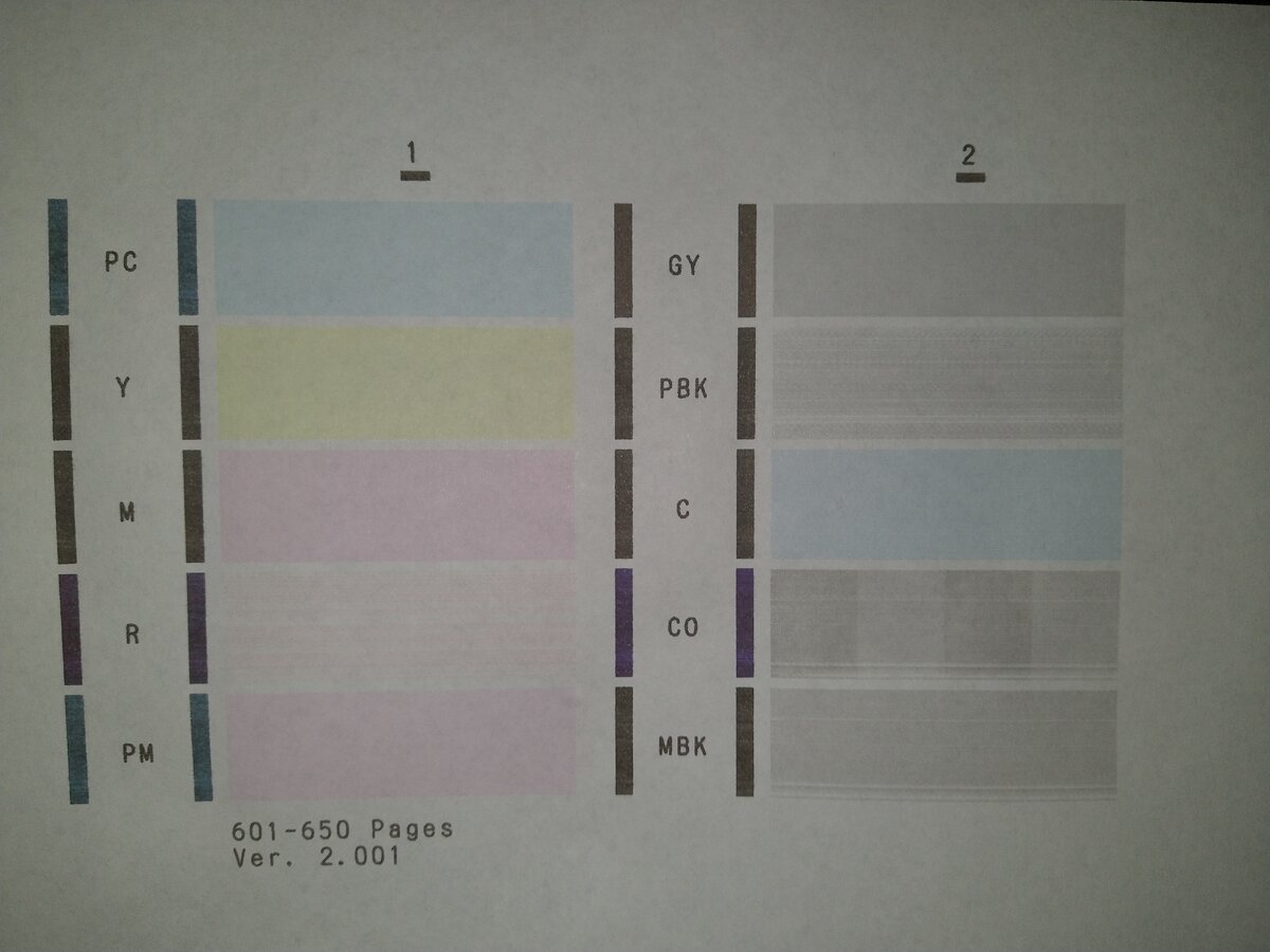

Been fighting with a used Canon Pro-10 I got from somebody who had not used it in years. At this point, I've tried soaking the print heads in windex and still have had no luck getting a perfect nozzle check. Are the heads damaged? Is there something else I should try? Any help is appreciated here!
15,942
8,945
Flood the purge unit with window cleaner, then try putting in a new set of carts and run a deep clean and then another nozzle check..
If there is no change then the head is probably beyond saving..

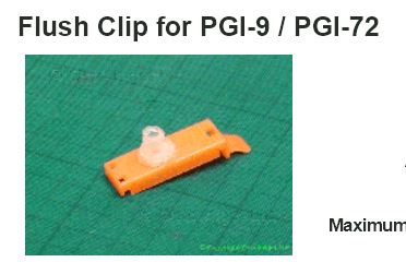

Alright, so I've replaced the PBK cartridge and it looks much better, which probably means that the MBK will also improve with the purchase of a new cartridge. However, I'm wondering if there is any way to save the old cartridges. Is there anything I can do here? I've seen the concept of flushing a cartridge thrown around here, would that help?
15,942
8,945
The carts are very easy to flush, but you need a special modified clip, that way you can rinse the cart with Window cleaner using a syringe, push the fluid in and sucking it out again a few time..
You can make a clip yourself, or buy them readymade..

That nozzle check is probably recoverable with good management. Try to view with a loupe or by scanning with high resolution to see the individual dots. You will see that white lines often still show lighter and smeared out dots, meaning the ink flow is not completely interupted.
No experience with Ink Owl (in particular mixed with other ink, something I always avoided).
As said, the best way to recover a PRO-10/PRO-9500 printhead is good ink and patience. IMO cleaning cycles do more bad than good.
I think a set of original cartridges is too expensive given the situation.
Best you could do is remove the printhead and soak it a night (or two) in distilled water with dishwashing liquid - for the sink not the machine), dry it properly before reinstalling, rinse and fill your carts with Ink Owl as explained, and do nozzle checks and one or two cleaning cycles every day until it enhances.
Fingers crossed, but since I refill my printers with Canon ink (from large format carts for the PRO-10/PRO-9500 and refill bottles for the Maxify) I seldom or none have clogs.
