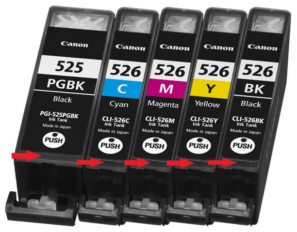

There is no "low yield" 526. The cartridges that come with the printer are full. You can see the level in the ink compartment of the cartridge if you look at the end of label:
<-- click to enlarge
Tilt the cartridge forward and you will see air. Tilt it backwards and you will see ink.

Thank you for your quick response and picture, I wondered why I could not see any difference between the two sets (I also purchased a spare set too) which on the packaging explains the quantity in each, the ones that came with the printer were loose (although shrink wrapped), it was the sales assistant that told me they were low yield (obviously to get me to spend more on a spare set!!!)
