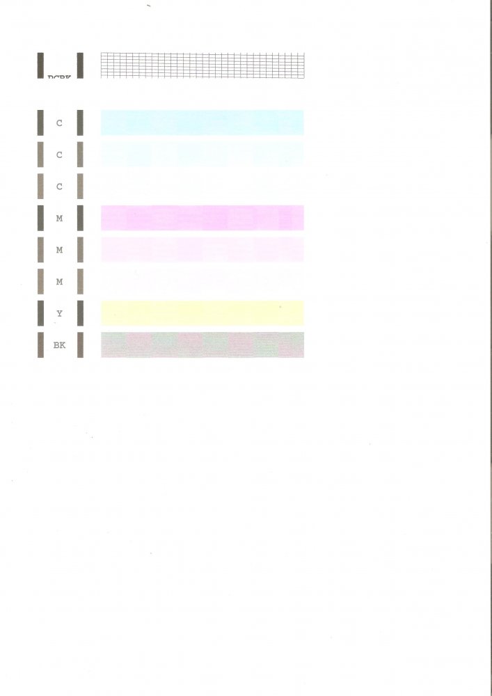

I have had my Canon Pixma iP4500 printer for 10+ years and have been running it with a rihac CISS for the past 6 years with no problems.
I use the printer fairly regularly - mainly for photo prints. I recently transported the printer for use at a function and suspect that this may have upset the CISS system !!
A few days ago I noticed that the printer was not printing text, although it would still print photo's OK. Further investigation revealed that the ink cartridge was not re-filling as it should and had run out of ink. I primed the system, with no improvement. I also reinstalled the drivers and gave the print head a clean with water, again with no improvement.
The problem is that only half the print seems to be working. You will notice the top line of the Nozzle Check - only the top half prints. The same thing happens for all text prints.
I am guessing that this is not a 'blocked head' issue as there is not even a drop of ink in the bottom half. I am guessing that is an electronic issue that can't be fixed. All other colours are fine - it may not look like that in the attached image but that is just due to my poor scanner
Any advice would be appreciated - I really like this printer and would like to fix it if I can.
Cheers
