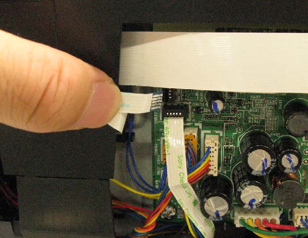

The small circuit board with the USB receptacle is not the logic board but the Pict Bridge input board. It allows printing of pictures directly from a camera also equipped with Pict Bridge. The logic board is a larger board that can be seen in the service manual on page14/17 the picture at the right below paragraph 7), see this, click to enlarge:
The parts number for the logic board is QM3-4393-000 but beware if you want to search the web for one. Canon has divided the world into regions and a printer for one region only works with cartridges for the same region. I don't recommend risking to buy a logic board from a wrong region that might be functional but useless.
