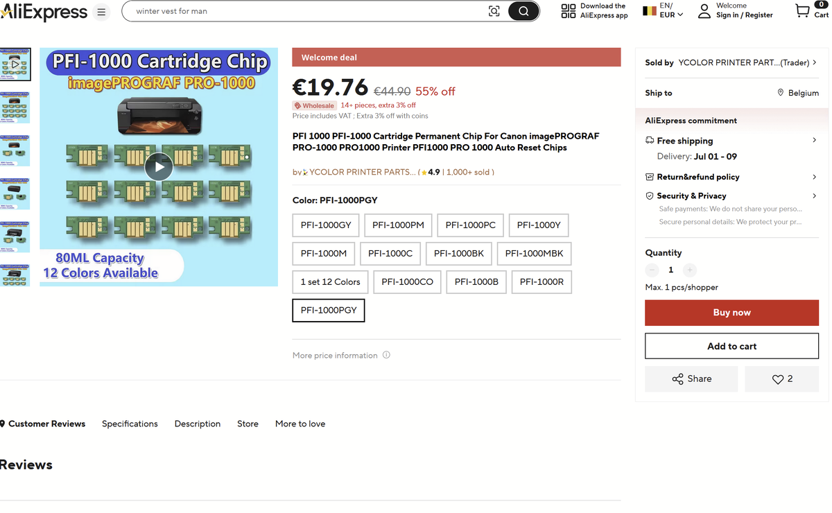

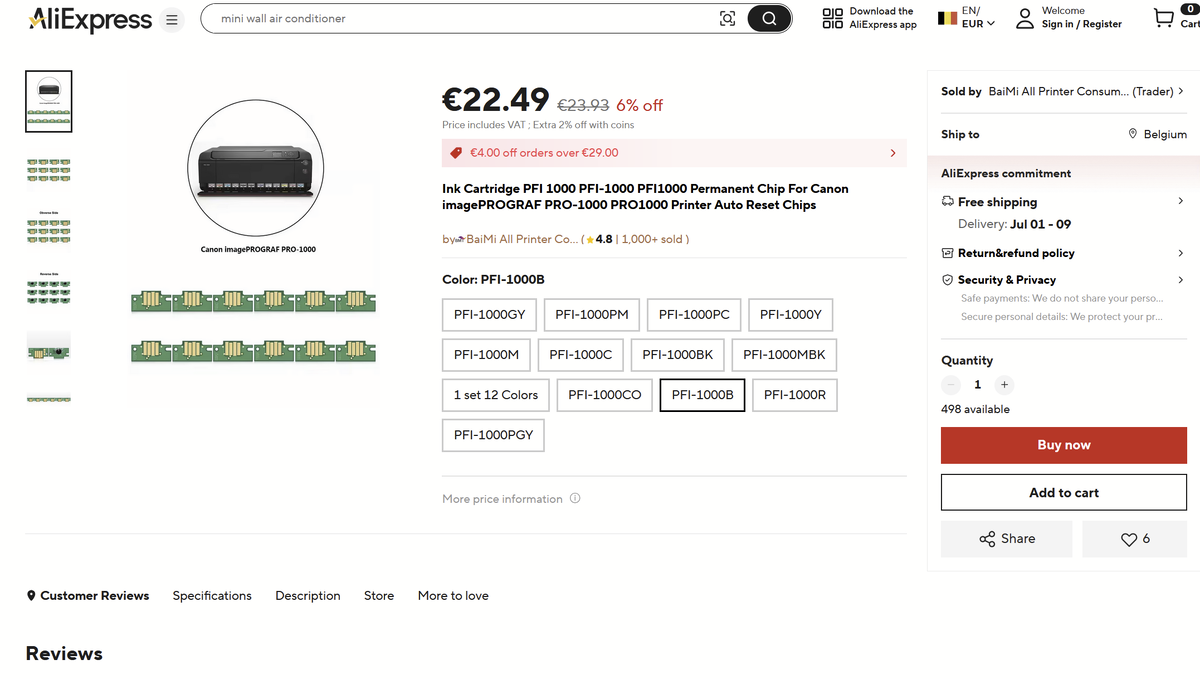

You might have a check here on aliexpress.com:
https://www.aliexpress.com/item/1005008235796254.html?spm=a2g0o.productlist.main.2.591fDGKiDGKiDe&algo_pvid=9a271868-a9d6-462b-8305-512630c7995d&algo_exp_id=9a271868-a9d6-462b-8305-512630c7995d-1&pdp_ext_f={"order":"2","eval":"1"}&pdp_npi=4@dis!EUR!45.31!20.39!!!50.96!22.93!@211b807017505717693363900ec03d!12000044326511589!sea!BE!123438529!X&curPageLogUid=EA21bZCoTgx0&utparam-url=scene:search|query_from:
Hefty costs, but if it is auto reset chip you may have covered the burden even after the consumption of 1 set of cartridges with a good aftermarket ink. Note: I suggest to ask the seller if the chips will work on US-based printers for the auto reset chip function, because of the weak consumer protection laws in the US they can put special booby traps in the US printer firmware to disable the chips after 1 usage.
I have bought so-called one time chips for my Epson SC-P900 printer (the Epson equivalent of the Canon Pro-1000) and it turns out those chips can be easily reset by the corresponding chip resetter that supposedly can only reset OEM chips, but it works too on the aftermarket chips too, which was a great surprise to me. BUT in case of the Pro-1000 auto reset chips it might work (auto reset function) or in the worse case only one time and after that you have to disable the ink levels, but that should be bearable if that works and is only something you have to take care off regularly (check carts before a large print job and refill accordingly)
Thank you but my primary concern if if can fool the Canon pro 1000 into initializing for first time use with either one time or ARC and NOT the OEM chips which are missing on the OEM carts
Thank you !
2,815
1,625
SC-900 ET-8550 WF-7840 TS705
If the printer has used OEM chips in the first place placing aftermarket chips should not be a problem. Only if the printer is completely new and someone has sold the original setup cartridges would be a problem:
The link is broken because printerknowledge tends to remove the last characters, but try to find in aliexpress on Canon Pro-1000 cartridge chip autoreset
You should be able to find it:
Here is another supplier using the same search key words:
