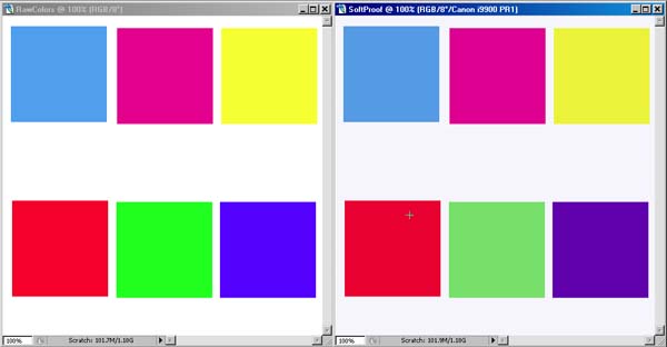

What really caught my attention was when I printed out what was supposed to be a DEEP PURPLE LOGO that came out NAVY BLUE!

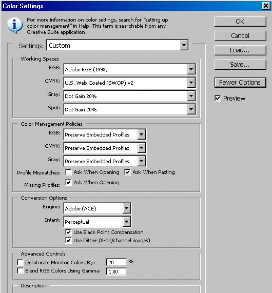

If you want to print accurate colors, you need to set up your system for color management. I have attached a copy of my Photoshop color setup:
Comments:
*AFAIK, there is no way to turn off Color Management in Photoshop. You can turn color management off in your printers driver, but the colors will then be really unpredictable.
*The RGB working space should be sRGB, aRGB, Apple RGB, ColorMatch RGB or even Bruce RGB, never your monitors profile. The monitor profile does contain a color space, but it isnt useful as a working color space.
*It is very difficult to judge color from a scanned image because a) Most scanners arent calibrated and b) most scanning packages automatically adjust the brightness/contrast/color balance.
It is important to realize that a monitor cannot display all of the colors that your eyes can see, and that a printer also cannot print all of the colors that your eyes can see. Further, the range of colors that each device can generate (their color gamuts) have some colors that overlap, but they also have colors that cant be generated on the other device. This is especially the case with green and blue. The attached image shows a screen shot of your starting colors and what they look like after soft-proofing with an i9900 profile for OEM ink and PPPro paper. Therefore, you would probably see a similar problem with OEM inks, as the printer cannot print the color that you are looking for.
Note that the screenshot captured the color numbers after they passed through the monitor profile. For this reason, the absolute colors on the preceeding image aren't exactly the same as they appeared on my monitor, but the relative changes in color between the two images are still valid.
