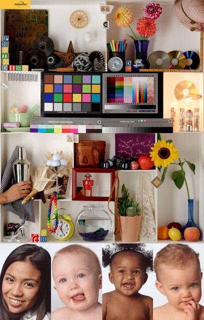

I wasn't able to find the first image (Adobe ColorFile.tif) on the internet, but was able to obtain a copy (thanks Wil). At the risk of infringing on I.P. here is a link to the non-text-layer version , and a text-layer version .

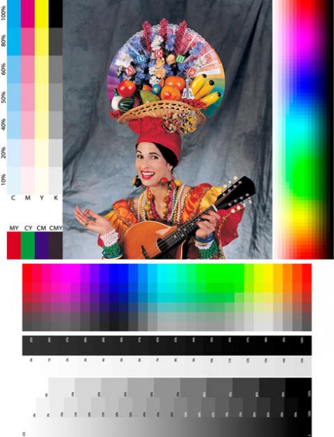

The third image is from the website of the author of "Fine art printing for photographers : exhibition quality prints with inkjet printers", by Uwe Steinmueller. Here is an essay explaining what to look for when evaluating a print made from the .tif file. And a link to a .tif file with a text layer (70mb .tif file)
