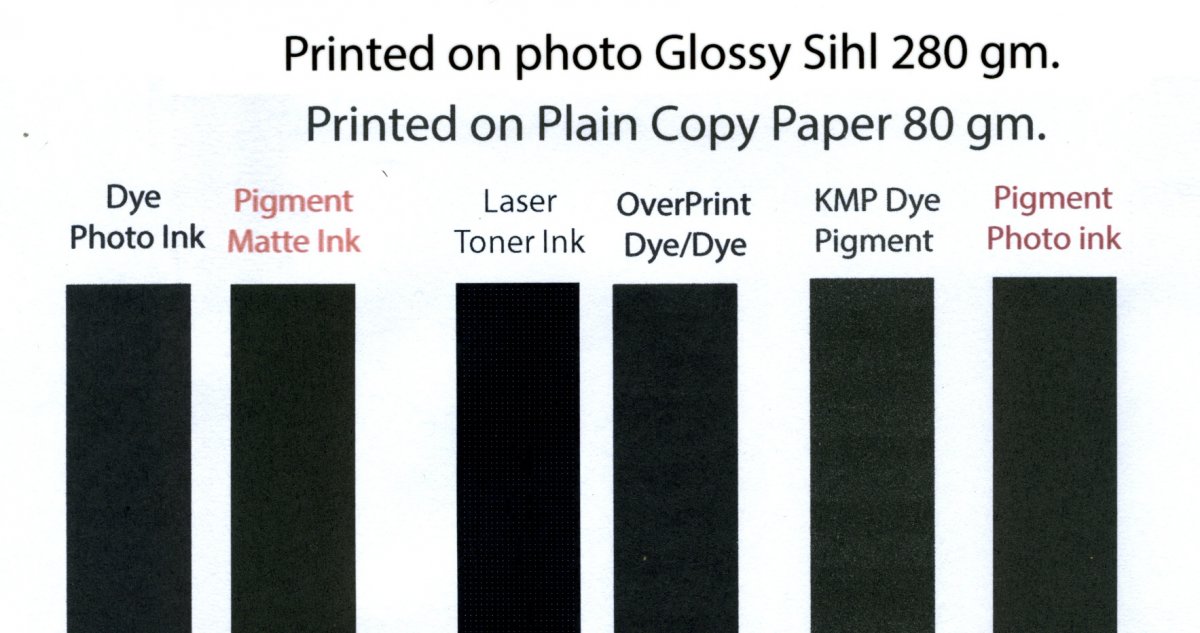

What I have found mostly with inkjet ink that the black will fade just as quickly as the colours will, so I printer out this swatch and placed it in a window in direct Sunlight.
I don’t imagine I’ll have to wait to lone for the results, maybe 4 to 6 weeks, and that should show quite a bit of change in some of the black inks.
I used several different black inks, starting with from left:- FotoRite photo dye, I.S Pigment Matte, Laser Toner, Again FotoRite Photo dye (Over Print) dye on dye, KMP Pigment, and lastly I.S. photo pigment.
The idea was to print them on two types of paper surfaces, Plain copy and photo glossy papers, I altered the Media type to get each Black to print on the two surfaces, and I omitted the Laser ink sample on the glossy surface for obviously reasons.
I also put a coating of Glob over half of the swatch on both papers and then covered the middle section with a piece of card to block out the light waves.
Hopefully we’ll see how each of these different inks get on in this random test in September.
The is just a quick sample on how I laid out each black strip for illustration purposes..

Here are the black ink tests that were done over the last two months.
This is not a scientific or a carefully controlled test, its just to show what happens to your black ink when exposed to constant daylight, notice I didn’t say sunshine...:D
The Top Half was exposed to everyday light and the Bottom Half was covered over with a bit of card, not exactly scientific because it was not held firmly against the surface properly allowing some reflected exposure to take place.
On the Glossy Paper, as you can see I had 5 different Black Swatches.
The first swatch was FotoRite Photo Black dye ink especially made for Glossy Surfaces.
2) Was the I.S. 9500 Pigment Matte Black made for Plain Paper. (3rd not used)
4) Was the same ink as the first, but Overlaid Twice, in the Same Position.
5) Was the KMP simulated Pigment black especially made for Plain Paper.
6) Was the I.S. 9500 Pigment Photo Black especially made for Glossy Surfaces.
You can see the effects clearly yourself, there is not much difference in any of the different black inks except the FotoRite which went brown as expected but surprisingly enough number (3) held up quite well with the double application of ink.
The Second Test was the same as the First but this time on Plain Paper and with 6 swatches.
The first was FotoRite Photo Black ink made for Glossy Paper.
3) Was the Mono Laser Toner at 300 DPI, it wasn’t used on the Glossy Paper test.
4) Was the same ink as the first, but over printed Twice like the previous one was.
5) Was the KMP simulated Pigment black made for use on Plain Paper.
6) Was the I.S. 9500 Pigment Photo Black made Glossy Paper.
The effects this time were that all of the swatches faded just a tad, except the laser Toner, and the FotoRite is simply a lost cause as is most of all dye black inks are.
I did cover half of the swatches with a coating of Glop, but it didn’t have any effect at all, and the header text was printed with dye ink, just in case someone asks, and two in red are from the Pro printer....

What I don't really understand is this "KMP simulated Pigment black"..??
Is the fotorite ink the only dye ink in the test?
16,162
9,114
The KMP ink is formulated for use in the desktop Canon printers, all dough classed as pigment ink its somewhat different than that the normal pigment inks, as far as I can tell, and the FotoRite is the only true dye ink in the test set and the only one I got...

your testing shows as well that a dye ink fades to brown on the Sihl paper, and the same ink may fade to a more neutral gray on another paper, in this case on plain paper. And the impact of a gloss optimizer onto the fading performance is at least questionable.
I'm looking to my patches partially covered with GO, it vanished on the Labelheaven CC paper, it probably migrated into the coating/paper and does not impact the fading at all. The GO on the Tecco paper creates an ugly crimpled surface, probably as an effect of the outside environment, changing humidity, sun etc, and there is no impact on the fading of the Fujifilm inks either. It could very well be that the formula of the GO is different between 3rd party ink suppliers - I don't know - that would require another test cycle - several different GO types on various different papers .....
A short test with cheap inks last year and GO showed some improvement, but that combination would not catch up with the better inks at all. The GO does its job on pigment inks, but does not appear to do any good in combination with dye inks.

I like to do accelerated tests--in direct sunlight or held against a fluorescent tube. With this kind of abuse, all the the third-party black dyes I have tested are among the most unstable inks I have tested. I just use OEM photo black.
On the other hand, all the text pigment inks I have tested are quite fade-resistant.
