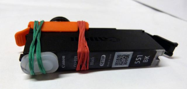

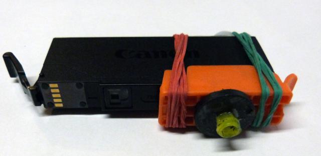

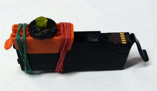

I made up this refiller by using an OEM orange clip and fitting a luer lock needles top to it held on with Araldite adhesive.
It wont to long I imagine before either Websnail or Mikling produce a commercial version of my refill clip
and have it on sale on their individual websites, if you cant wait then make your own one up.
The OEM clip itself is a bit weak at holding on to the cartridge with its little hooks so I placed a red rubber band over that area,
just in case it fell off as there will be no pressure applied to blow it off.
To cover the air maze I used a silicone washer from the bottom of another clip and held it on with the green rubber band,
it work pretty good but I think Ill use something a litter better next time.

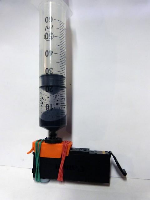

I started with the cartridge on top of a 60 ml syringe and pulled back on the plunger to extract all of the remaining ink
that was left inside and left it to stand for a couple of minutes.
Then I refilled the syringe with about 20 ml of ink, it doesnt matter how much
you put into the syringe so long as its enough to do the job.

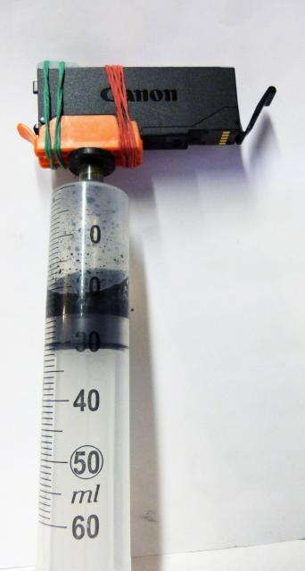

This is the important bit to watch out for, with the cartridge on bottom this time
pull back on the plunger as much as it can go and then let go.
DO NOT BE TEMPTED TO PUSH on the plunger under any circumstances whatsoever no matter what.
Just repeat pulling on the plunger several times till you think you have put in enough ink into the cartridge,
you can at this stage change the angle of the cartridge is you think it will help get more ink in.
Leave your cartridge to stand for a minute or two then remove the syringe and your all done,
and I repeat it once again dont push on the plunger its not necessary
and it wont serve any purpose other than spilling ink everywhere.
I weigh my refilled cartridge and I got it to 25 gm. which included the OEM unmodified clip,
now I taught that was pretty good for my first attempt and was fairly satisfied,
the same cartridge when new weight in at 26 gm. with the orange clip attached.
