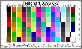

I'm using a small target patch sheet to create profiles, this patch sheet can be smaller than 10 x 15 cm, it's actually 11 x 6.5 cm, with 96 colors, and is printed with the Epson 106 inks
I scan this directly (+ a few hours ) after print and one week later again - on two papers at this time - a budget level cast coated Logic Seek 250 gr and a HP Premium Plus Photo Paper

The sequence on this list is arbitrary and does not indicate any ranking at this time, I'm doing this test with the 96 patch test chart shown above and i1Profiler software.

Let me show you some details of the measuring methods to run these fading tests. I was using a simple approach intentionally in the past - no need for expensive software/hardware like the i1Profiler package, I was tracking the luminance changes of 4 color patches with the C M Y K colors printed onto the paper target under test -and with n the ink under test or for reference, and I was tracking the luminance changes via histogram readouts of the scanned patch sheets , this test is consistent in itself, I'm recording the changes of the CMYK prime ink colors , can repeat such a test and I can compare results with different inks and papers, and about everybody could do that the same or a similar way.
Using the i1profiler package - with the i1Pro2 spectro and the resp sofware - you can do more - scan more patches, get more calculations done, but this adds variability into the measuring process.
I'm using a 96 field patch sheet which I otherwise use for profiling 4"x6" papers, the target image just fits onto 1 sheet. And I'm using it as well to track the color changes of the patches. The layout is quite simple - an even distribution of control points aover the complete RGB color space - all corners and edges occupied with additional control points and more inside the RGB volume. You can get a 3D view like this:
