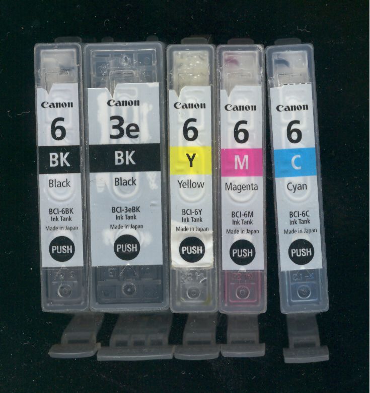

A common cause for cross contamination is one or more cartridges leaking. So what brand of cartridges are you using ? I have had similar problems with a cyan after-market cartridge leaking. The yellow turned green and the magenta a dark colour. Leakage and other problems are seldom seen with Canon original cartridges, so if you want to refill, use only Canon OEM cartridges.
If you want to refill, I recommend the "German" or "Durchstich" method. Here are excellent instructions: http://www.nifty-stuff.com/forum/viewtopic.php?id=2465&p=1
Another refill method is top filling. It may be easier than German method, but the drawback is that if the top fill hole is not sealed properly, the cartridge is sure to leak, even if it is Canon OEM. Do your cartridges have any screws or rubber plugs attached to the top (label) side ? If so, they have been top filled and you have a possible cause of leaking.
If the cartridges are Canon OEM they can be flushed and refilled. If they are not, you should throw them away and get some used OEM BCI 3/6 for refilling. If you only print a little then I recommend buying and using new Canon OEM's even if they are expensive. You may be lucky and find some after market cartridges that work well, but many Canon print heads have been ruined by using after market cartridges.
For comparison I've scanned and uploaded some Canon OEM cartridges, link here: http://www.nifty-stuff.com/forum/uploads/6881_bci_3_6_oem.jpg
In my opinion the problems are caused by the cartridges and not the printer, so it is not Canon's fault. I think this printer using non-chipped, easily refillable cartridges certainly is worth keeping.
So please post back with more information about the cartridges you are using.

It might be a leaking problem, but I don't think it's an after market problem. This is a cartridge like the one I'm using:
I think it's OEM, but I haven't been able to get anyone to say. I've taken up the issue of short-term solutions elsewhere.

Yes, that is an OEM cartridge. I think your problem is letting the printer sit idle for so long, as you say, printing "very sporadically". I would recommend that you do a nozzle check once a week to keep the nozzles open and to let you discover as early as possible when a problem develops.

If the cartridges are all Canon OEM, which have not been tampered with, that should rule them out as the cause of cross contamination.
But from your description of the discolouration it looks to me as if the BCI-6 BK is the culprit, as the yellow turned dark and the cyan turned dull.
My guess is that the cartridge may have been damaged or defective in manufacture, causing a small leakage of air into the ink chamber. Maybe the bonding of the top part to the rest of the cartridge was not perfect ? Maybe the suspected air leak is so small that problems only show up after the printer has been sitting idle for a long period ? I would not use that cartridge for refilling. The others can be refilled after a purging to remove the discoloured ink.
Hopefully your printer will be OK again with a new or refilled set of Canon OEM cartridges.
If changing the BCI-6 BK doesn't stop the cross contamination then I am out of ideas.
Peter.
