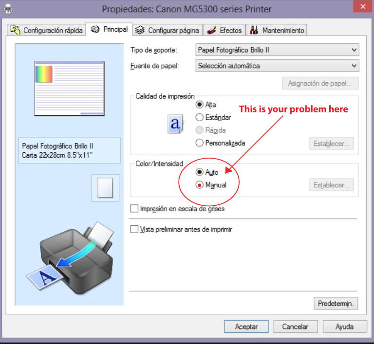

Hello, a few days ago I wrote a post about ink brands (ocp, inktec..). I decided to buy inktec inks for now.. because is more easy to get in my city.
With some troubles with the ciss(bubbles or air) , but finally works..
But.. when I send to print images like drawings, graphics or something else that not require full quality. works fine.. with enough quality.
When I send photo images to print I've poor quality on any type of paper,
I used paper canon glossy with and without profile canon driver, generic paper with gloss and matte,
with printer management color and photoshop management (better result with PS)..
and always same result.. sometimes a little better..
I did printhead aligment, cleaning, print test sheet..
What can I do?.. what could be wrong?

You could have any number of things wrong but with the little information you have provided it would be hard to tell with any accuracy.
Which O/S are you using and what printer setting are you using to print on the glossy paper, because it very much looks like your double profiling somehow and everything is gone wrong.
Try downloading this photo and don’t do any changes to it then reset your printer back to default and just use the media setting of glossy paper and let the printer do the rest, now see how that turns out compared to the original.. http://www.outbackphoto.com/printinginsights/pi048/essay.html

Thanks 'The hat', I'm sorry I don't know what information could be useful, if you can help me, I'll put all information that you need.
S.O. Windows 8.
Edition software: Photoshop cs 6
Photoshop settings:
document profile: sRGB IEC61966-2.1
color management PS
Intent: perceptual
Printer settings: almost are default
paper photographic
without border
type gloss II
Quality Hight
Type: gloss II
Print Quality: hight
Color/intense: Auto
Effects: empty
I use canon photo paper gloss II. oem, with the side more white to print.. ( I've tested both sides in my despair).

You have to select Color-Manual and hit Set. In the second tab select "None".

Open this printer tab and change it,
and follow @Tudor instructions above and then try printing your photos..

Thanks @Tudor and @The Hat
I made all changes, reset the printer settings, I don't have more canon photo paper. I used another brand with equals features for testing with much much better results.
All settings are exactly the same as before (using reset..) only two things have changed:
the paper.. and disable/enable: colour/intense.
I printed with both settings and works fine .. with color/intense in auto the colors are more intense,
then I printed again using 'Color/intense - / Manual/ Set - None' and the colors are less intense, even more blue and gray in all the picture.. like if the image haven't vivid colors.
Now viewing the results must be enable auto or enable manual with none?
For now.. issue solved. How?.. I don't know all settings are equals, only thing different is the paper.
Could be the paper or what thing?..
