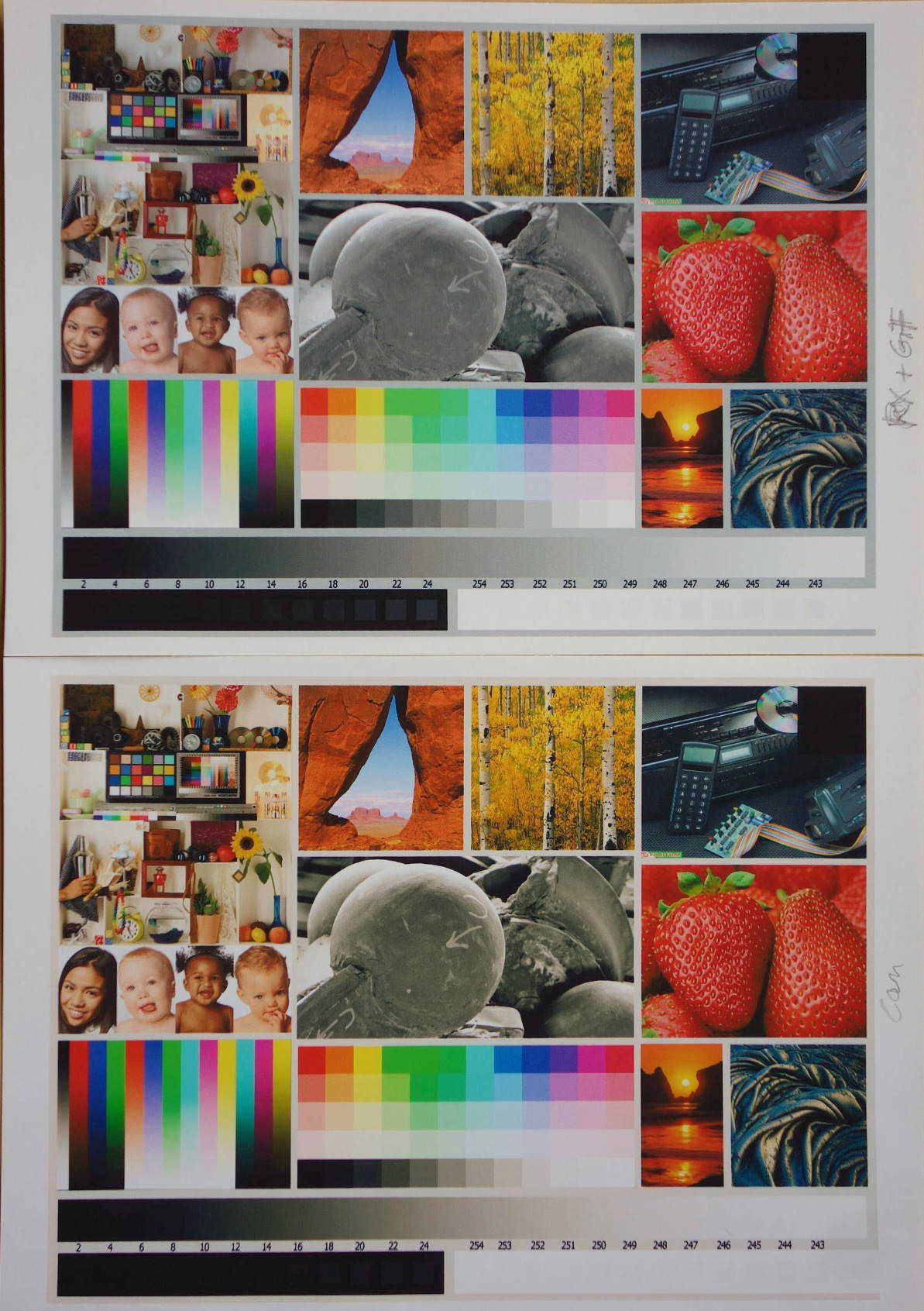

"Innovative new color management" for printers by using a digital camera:
..only in german so far..
http://www.colymp.com/
I made a quick test and here is my first experience:
Workflow:
- install the programm "colymProfiler" * (a free test version is available online, making prints with "white stripes")
- print the testchart out of the software with your printer
- take a photo of this print with your camera (settings neutral, manual WB on the white borders)
- save this photo and let colymp calibrate it.
The result is a calibration or printer profile for photos of this camera printed with this printer setting + ink + paper.
Now there will appear a virtual printer in your windows system called "colymPrint", you can print out of all editors.
But you can also export ICC profiles from your calibrations for use with adobe and co.
The quality of the profiles depends much on the quality of the photo of the printed test chart. Pay attention on exposure and white balance of the camera (no "vivid" or similar settings) and on neutral, uniform lighting too.
If the camera gives neutral colors, the profile could also match other cameras more or less.
You can shoot more than one photo (of the printed test chart) and use them for one profile, colymp will calculate the average.
In my opinion it is an interesting approach, if you don't have a spyder print or colormunki.
I posted a few more info's here:
http://www.dslr-forum.de/showthread.php?t=1179409&page=2
with a test photo of two prints, using canon driver settings and colymp profile:
http://forum.colymp.com/viewtopic.php?f=4&t=5281

Old thread .. but as I am using the software lately more and more, here is a result of profiling an inkjet paper in a canon A4 printer with 3rd party ink, using two cameras:
http://forum.colymp.com/download/file.php?id=14&sid=45ea8a6726023b458d59cc421183bdd1
So once you have found the right camera model with neutral settings and lighting (for me it's a sony RX100) the resulting profile surely can be used not only for photos of this camera ... and your workflow is getting easier
Beside this the software has a "virtual printer" module, which makes it very easy to choose a certain ICC profile, although the printer (like most A4 models) has no color management and does not support the choice of ICC profiles...
