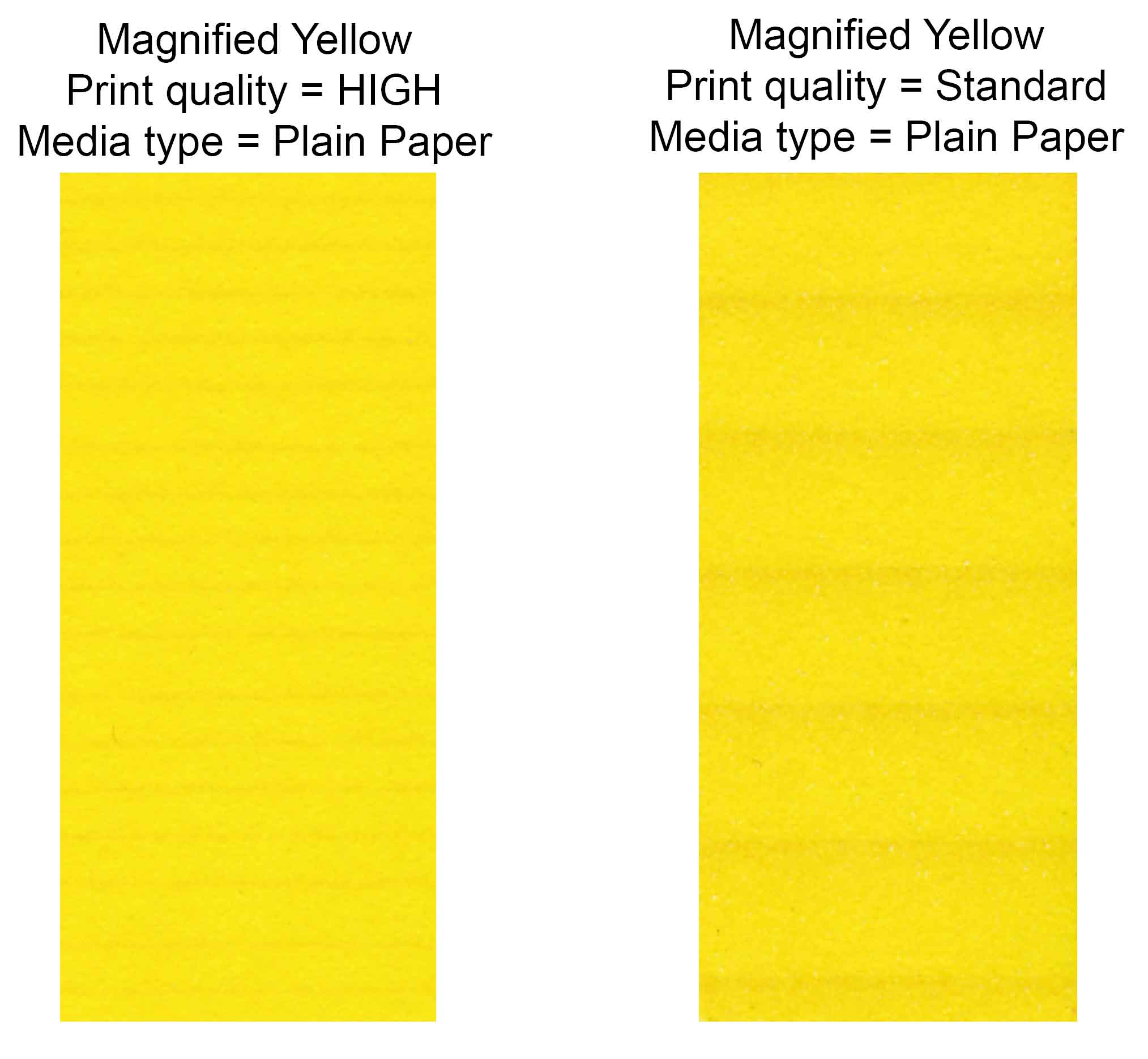

I manually aligned the head of a Canon MP980
I also let the printer do an automatic alignment but the results are the same
The printer is almost new running it's second set of OEM carts
Is it actually a problem ? (lines are visible mainly on the yellow and visible to the naked eye)
EDIT: Nozzle test print is 100%
Thanks :)

First off, I'm not sure what you mean by calibrating the printer. If you mean alignment, then I doubt that it has any effect on the yellow ink. In most Canon printers, there are two columns of nozzles for the cyan and magenta colors for each nozzle size, one column for printing when the head scans left-to-right and the other column for when the head scans right-to-left. The purpose of alignment is to set the timing so that the two columns of nozzles will print exactly on top of each other. See this topic for an explanation of what's going on.
Secondly, the discoloration that you see in your printouts may be caused by your original document. Where did you get it from? I would think the best pure color would be one you generated from Paint by filling the entire page with a solid color. It may make a difference whether you specify the document to be saved as a bitmap (.bmp), or a compressed file such as the lossy .jpg or the lossless .png. Try all three and see if there is any difference.

I once worked out that a print head costs well under a penny per nozzle; as such it can't be expected that each nozzle will deposit exactly the same amount of ink. This is why printing at high quality on photo paper is so slow - the paper only advances by 1/8 of the width of the nozzle bank for each pass of the print head so that any light/dark areas are randomized, masking print head defects by using 8 different groups of nozzles to complete the ink lay down.
When printing on plain paper at standard quality, the print head does its entire ink laydown in a single pass - making non-uniform ink flow apparent. Did you notice how fast this sample printed? High quality on plain paper will probably advance the paper 1/2 as far and make 2 passes - note that there are more defects and that they are less visible.
Repeat the test on photo paper. If the bands are still visible, send the printer to Canon if it is still under warranty.

The yellow in the picture from post #4 looks like pure yellow while the yellow in post #1 looks a little muddy. Is that because you scanned it and your scanner introduced a color difference?
I know that your first post has a magnified image but I'm wondering how you did this. Did you simply print the image from post #4 so that it was as small as it appears in that post and then scan it and magnify the scan or did you magnify the image before you printed it?

No I did not magnify the image before I printed it
I dloaded the image
loaded as is in photoshop
printed using 2 printing modes (high and standard) on same paper type. It was here that I noted that the yellow was not looking good. I could see the lines in the 2 prints
scanned the images (2)
enlarged the yellow part
Please note that I can see the lines only on the yellow color in both printing modes (high and standard)
