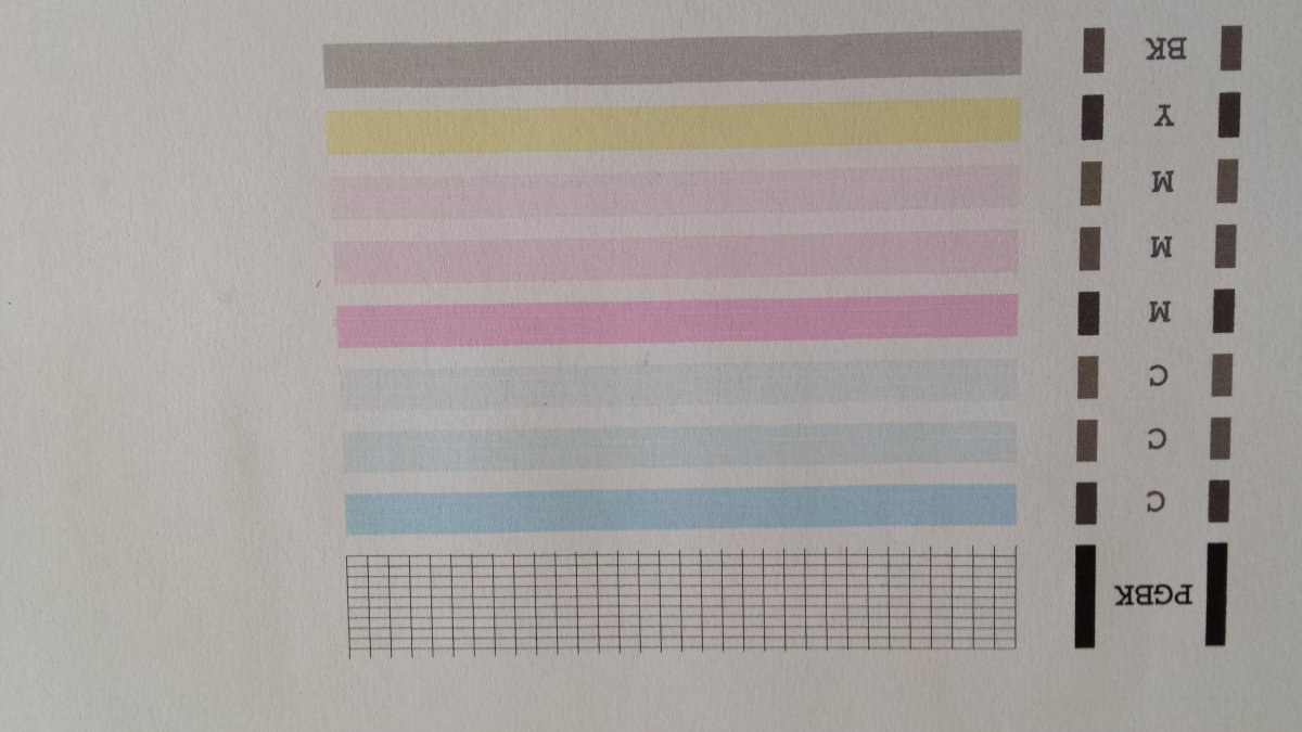

canon MP620
Hello PeterBJ,
here's a new Nozzles check, after leaving the printhead in a Ajax Windows cleaner with a little bit of Isopropyl Alcohol 17 hours and washed and dried out (no water drops nowhere found before I plugged in again ;-)
It seems to be good or...?
Tell me what you think about.
Thanks in advance

5,109
4,967
Hello PeterBJ,
Thanks in advance
Best regardsView attachment 1429
The pigment black pattern looks perfect now, but it looks to me like there is some cross contamination and some missing nozzles in the dye test stripes.
If you are lucky one or two nozzle cleanings from the driver's maintenance tab will clear out the cross contamination. The missing nozzles might be caused by air in the print head, hopefully the cleaning will re-prime the print head and make all nozzles work again.
I have experienced the same with a print head for a MP540 I had cleaned. Over a couple of days with only test printing the pattern improved and was almost perfect.
Some say that the nozzles are fired during a nozzle cleaning, so I think it is best to avoid using the extended nozzle cleaning, it stresses the print head more and dumps more ink in the absorbers. If necessary you can use two regular nozzle cleanings with a cooling pause of a couple of minutes between them.
The "Test Print" from service mode prints grid patterns for all colours, so this is better for checking the condition of the print head. The printed patterns are small, so good light and a magnifier might be a good help in studying the test patterns, if you have reached the "reading glasses age".
