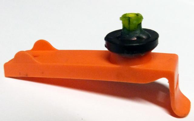

I got a pair of modified orange clips the other day, one for each size cart large and small
which makes purging any cartridge pretty easy in fact downright simple.
I had all four carts cleaned out in no time at all using a 60ml syringe to push plain water
into the outlet hole and exiting through a drill hole in the top of the reservoir.
I made one up myself a while ago but it needed to be held on with a rubber band
but these new ones just clip on neatly and before you ask I got them from OctoInkjet.

Ah ha Peter you caught me out, yes they will be generally available and no it wasnt a one off special order for me.
The new clips will be online in about 72 hours, I was buying more empty carts from websnail
and I just got the chance to test them out first.
Both Tudors and your own rigs do work very well as did mine,
but these new ones are much more convenient than the lot.
All thats need extra is a 60ml. syringe and a cupful of water (Soft in my case)
then with a couple of squirts of water with the syringe and your done, fast Id say..
I place my cartridges to dry using ghwellsjr tissue paper and the screw attached idea,
sitting on a larger piece of tissue which causes the cartridges to wick much faster, less than an hour..:)
